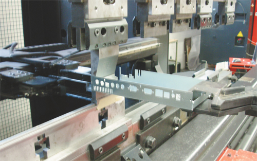

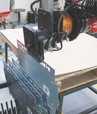

Forming enclosures for Suntron and ZeeVee at a Metal Works’ robotic bending cell begins with a robot pulling a blank—prefabricated on a turret press—from a rack and placing it against automated backgauges in a press brake.

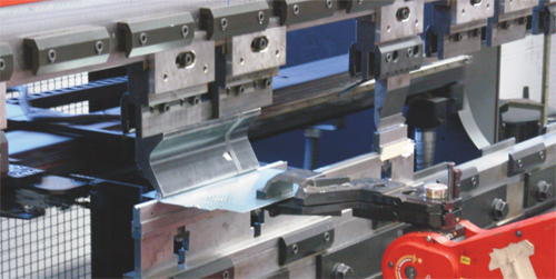

As a result, Pierce opted to add a pair of Amada 10-ft.110-ton Astro II 100NT robotic forming cells to his stable. The automated forming cells, says Pierce, completely integrate what he viewed as two separate functions—a press brake that goes down and up, and robots that feed sheet in and out and position parts against multiaxis backgauges.
“Through software and integration,” stresses Pierce, “the two technologies act in sync. We’re able to teach the robots and press brake, through the cell’s control functions, how to truly work together. As a result, we’re able to run both robotic cells with one operator, optimize green-light time and generate cost savings we can pass along to customers. That’s allowed us to grow our business in areas where we had not been able to previously.”

High-mix small-lot production, it turns out, is exactly what the Astro II 100NT is configured for, with remarkably fast backgauge motion (80 mm/min.) and two robots working in concert to move material in and out of the cell, while positioning parts against the backgauges in sequence. The press brakes are 110-ton HDS-1030NT models with 122.4-in. bending length and 7.9-in. stroke. The robots? They’re five-axis models with 44-lb. weight capacity capable of handling blanks to 31.5 by 39 in. (or 11.8 by 70.9 in.).

Metal Works launched production for Suntron in October 2011, and Pierce expects to support ZeeVee’s growing business with production runs in batches of 1000 to 2000 every few weeks. The enclosures measure roughly 18 by 24 in., fabricated from 18-gauge mild-steel sheet that arrives at Metal Works in 4- by 8-ft. blanks. Turret presses prefab the blanks, adding lances, slots, holes and extruded and tapped holes, which then move to the Astro II 100NTs.
