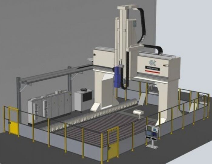

ASTRO-metal-3d-printer-army-jointless-hullThe U.S. Army Combat Capabilities Development Command, known as DEVCOM, and its Army Ground Vehicle Systems Center (GVSC) plans to build (reportedly) the world’s largest metal 3D printer, for printing large parts for military ground vehicles. Called the Jointless Hull project, the effort is being coordinated and led by prime contractor Applied Science and Technology Research Organization (ASTRO) America, Bethesda, MD, which will work together with subcontractors Ingersoll Machine Tool, Siemens, and Meld Manufacturing to manufacture the hull-scale machine.
The 3D metal printer, expected to take 14 months to complete and which will be installed at Rock Island (IL) Arsenal--Joint Manufacturing and Technology Center, will have the capability to print parts to 30 ft. long, 20 ft. wide and 12 ft. tall.
