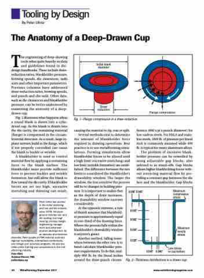

Fig. 1 illustrates what happens when a round blank is drawn into a cylin- drical cup. As the blank is drawn into the die cavity, the remaining material (flange) is compressed in the circum- ferential direction. As a result, large in- plane stresses build in the flange, which if not properly controlled can cause the blank to buckle or wrinkle.
A blankholder is used to control material flow by applying a restraining force to the blank surface. The blankholder must provide sufficient force to prevent buckles and wrinkle formation, but still allow the blank to flow toward the die cavity. If blankholder forces are set too high, excessive stretching and thinning can result,

Fig. 1—Flange compression in a draw reduction.

  0.046" 0.045"
0.043" 0.042"
0.040" 0.035"
Maximum compressive stress
Maximum tensile stress
Low stress
in cup bottom
                    0.040" 0.040"
  48 MetalForming/September 2017
Fig. 2—Thickness distributions in a drawn cup.
