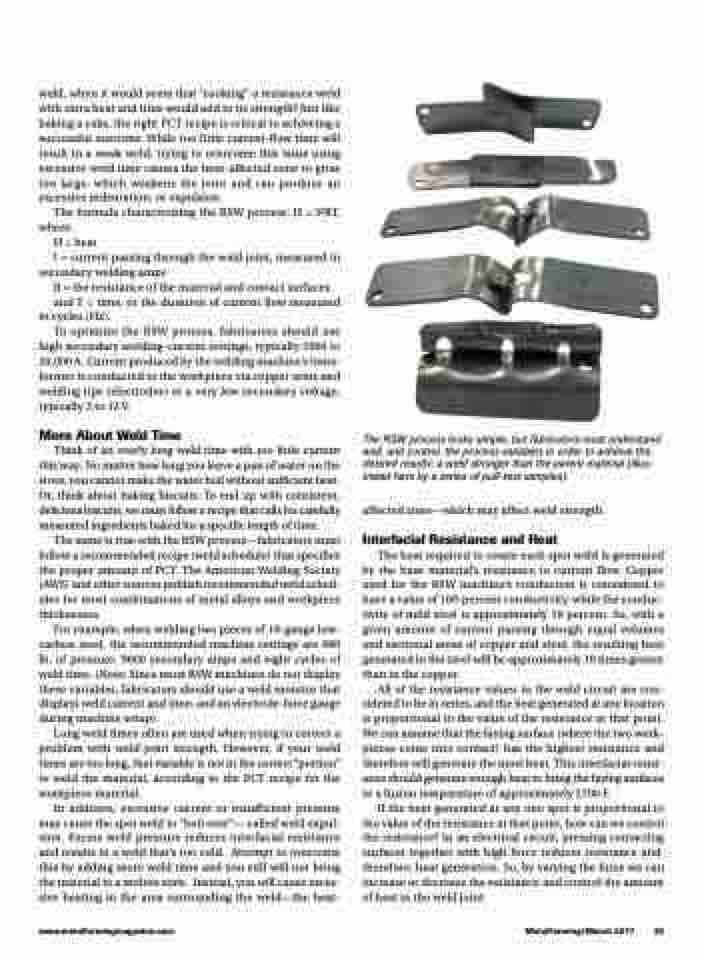

The RSW process looks simple, but fabricators must understand well, and control, the process variables in order to achieve the desired results: a weld stronger than the parent material (illus- trated here by a series of pull-test samples).
affected zone—which may affect weld strength.
