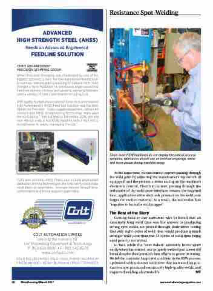

Since most RSW machines do not display the critical process variables, fabricators should use an external amperage meter and force gauge during machine setup.
