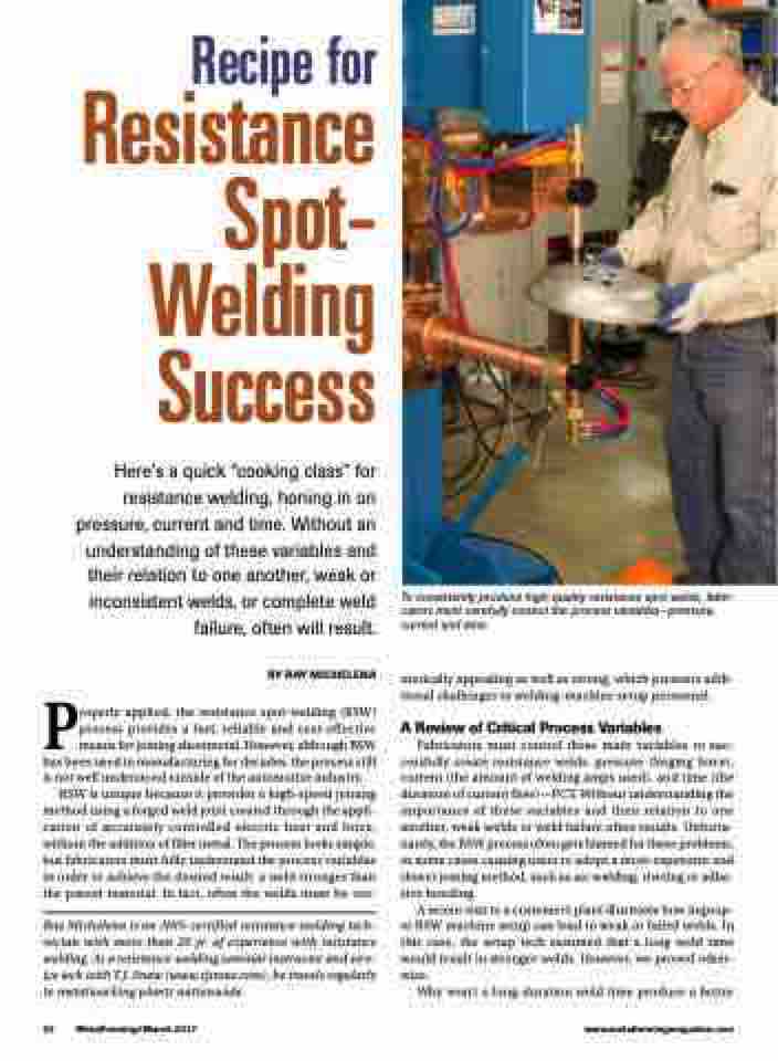

Here’s a quick “cooking class” for resistance welding, honing in on pressure, current and time. Without an understanding of these variables and their relation to one another, weak or inconsistent welds, or complete weld failure, often will result.
BY RAY MICHELENA

To consistently produce high-quality resistance spot welds, fabri- cators must carefully control the process variables—pressure, current and time.
