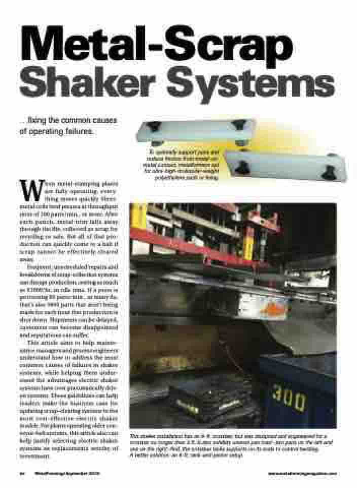

To optimally support pans and reduce friction from metal-on- metal contact, metalformers opt for ultra-high-molecular-weight polyethylene pads or lining.

This shaker installation has an 8-ft. crossbar, but was designed and engineered for a crossbar no longer than 3 ft. It also exhibits uneven pan load—two pans on the left and one on the right. And, the crossbar lacks supports on its ends to control twisting.
A better solution: an 8-ft. rack-and-pinion setup.
