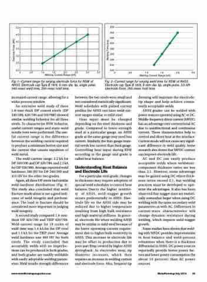

  5.0 4.5 4.0 3.5 3.0 2.5 2.0
0 0.5
1.0 1.5
Welding Current Range (kA)
3.0 3.5
       2.0 2.5
  360 340 320 300 280 260 240 220 200
0 0.5 1.0
          1.5 2.0 2.5
Fig. 1—Current range for varying electrode force for RSW of AHSS. Electrode cap Type B 16/6, 6-mm-dia. tip, single pulse, 340-msec weld time, 250-msec hold time.
Fig. 2—Current range for varying weld time for RSW of AHSS. Electrode cap Type B 16/6, 6-mm-dia. tip, single pulse, 3.5-kN electrode force, 250-msec hold time.

An extensive weld study of three 1.6-mm-thick DP coated steels (DP 340/590, 420/780 and 550/980) showed similar welding behavior for all three steels. To characterize RSW behavior, useful current ranges and static-weld tensile tests were performed. The use- ful current range is the difference between the welding current required to produce a minimum button size and the current that causes expulsion of weld metal.
