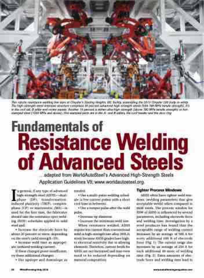

 This robotic resistance-welding line stars at Chrysler’s Sterling Heights, MI, facility, assembling the 2015 Chrysler 200 body-in-white. The high-strength-steel-intensive structure comprises 30 percent advanced high-strength steels (550-780 MPa tensile strength). It’s in the roof rail, B-pillar and rocker panels. Another 10 percent is either ultra-high-strength (above 780 MPa tensile strength) or hot- stamped steel (1000 MPa and above). Hot-stamped parts are in the A- and B-pillars, the roof header and the door ring.
