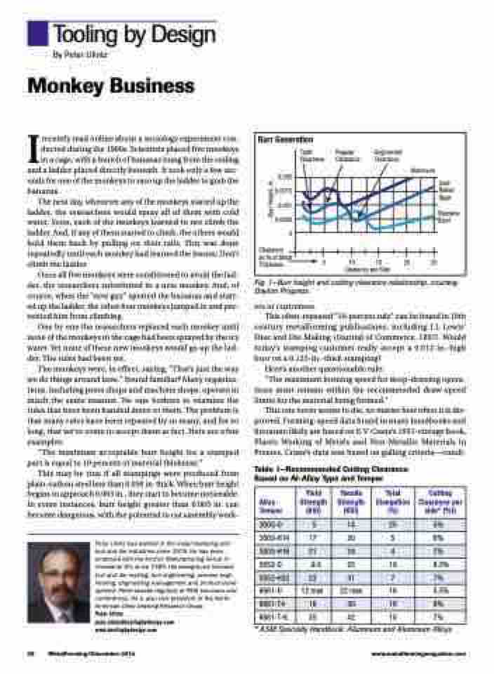

“The maximum acceptable burr height for a stamped part is equal to 10 percent of material thickness.”
This may be true if all stampings were produced from plain-carbon steel less than 0.050 in. thick. When burr height begins to approach 0.003 in., they start to become noticeable. In some instances, burr height greater than 0.005 in. can become dangerous, with the potential to cut assembly work-
Peter Ulintz has worked in the metal stamping and tool and die industries since 1978. He has been employed with the Anchor Manufacturing Group in Cleveland, OH, since 1989. His background includes tool and die making, tool engineering, process engi- neering, engineering management and product devel- opment. Peter speaks regularly at PMA seminars and conferences. He is also vice president of the North American Deep Drawing Research Group.
Peter Ulintz pete.ulintz@toolingbydesign.com www.toolingbydesign.com
Fig. 1—Burr height and cutting clearance relationship, courtesy Dayton Progress.
ers or customers.
This often-repeated “10-percent rule” can be found in 19th
century metalforming publications, including J.L Lewis’ Dies and Die Making (Journal of Commerce, 1897). Would today’s stamping customer really accept a 0.012-in.-high burr on a 0.125-in.-thick stamping?

Table 1—Recommended Cutting Clearance Based on Al-Alloy Type and Temper
  Burr Generation
Tight Clearance
Regular Clearance
Engineered Clearance
   0.002 0.0015 0.001 0.0005 0
Clearance
as % of Stock Thickness
