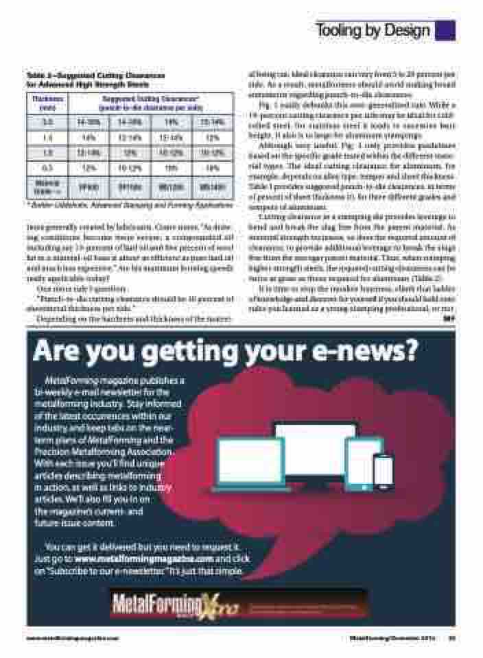

                                  Table 2—Suggested Cutting Clearances for Advanced High Strength Steels
al being cut, ideal clearance can vary from 5 to 20 percent per side. As a result, metalformers should avoid making broad statements regarding punch-to-die clearances.
Fig. 1 easily debunks this over-generalized rule. While a 10-percent cutting clearance per side may be ideal for cold-
2.0
1.5
14-16%
14%
14-16%
12-14%
14%
12-14%
12-14%
12%
Tooling by Design
  Thickness (mm)
Suggested Cutting Clearances* (punch-to-die clearance per side)
           1.0
 0.5
     Material Grade ->
12-14%
12%
DP800
12%
10-12%
DP1000
10-12%
10%
MS1200
10-12%
10%
MS1400
 * Bohler-Uddeholm, Advanced Stamping and Forming Applications
