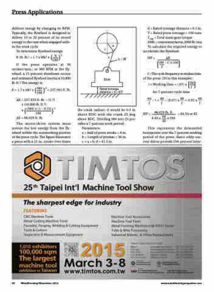

delivers energy by changing its RPM. Typically, the flywheel is designed to deliver 10 to 20 percent of its stored energy to the ram when engaged with- in the work cycle.
To determine flywheel energy:
E(ft.lb.)=1.7xWk2 x(N )2 100
If the press operates at 30 strokes/min., or 360 RPM at the fly- wheel, a 15-percent slowdown occurs and estimated flywheel inertia is 10,800 lb-ft.2 The energy is:
E=1.7xwk2 x(360)2=237,945ft.lb. 100
􏰀E=237,935ft.lb.–(1.7) x(10,800lb.ft.2)
x ((360) x (1 – 0.15))2
100 􏰀E = 66,029 ft. lb.
The motor/drive
restore the lost energy from the fly- wheel within the nonworking portion of the press cycle. The figure illustrates a press with a 12-in. stroke (two times
a c
x
Slide
b = 36"
d = Rated tonnage distance = 0.5 in. T = Rated press tonnage = 150 tons Tmg = Total main gear torque
2000 = conversion factor, 2000 lb./ton To calculate the required energy to
accelerate the flywheel:
HP= 􏰀E [(60–t)x550]
f
f = The cycle frequency or strokes/min. of the press (30 in this example).
t = Working time = (.07) x [60] f
26 MetalForming/November 2014
system
must
Rated tonnage distance = d = 0.5"
the crank radius); it would be 0.5 in. above BDC with the crank 25 deg. above BDC. Dividing 360 into 25 pro- vides a 7-percent work period.
Parameters: a=halfofpressstroke=6in. b = Length of pitman = 36 in. c=a+b-d=41.5in.
for 7-percent cycle time
60 – t = 60 – (0.07) x 60 = 0.93 x 60
HP =
f f f f
66,029 lb. ft.
60 = 64.54 or 65
0.93 x 30 x 550
