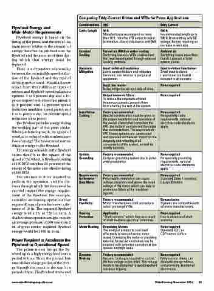

    Comparing Eddy-Current Drives and VFDs for Press Applications
 Considerations
VFD
Eddy Current
Cable Length
50 ft.
Manufacturers recommend no more than 50 ft. from the VFD output to motor termination, due to inductance and EMI.
500 ft.
Recommended length up to 500 ft. (transmitting only DC voltage) before requiring an increase in wire size.
External Cooling
Forced-air HVAC or water cooling
Switching losses in VFDs creates heat that must be mitigated through external cooling methods.
Ambient air
Switching losses equal less than 0.1 percent of total system power.
 Harmonic Mitigation
Input isolation transformer
Limits current to drive and mitigates harmonic interference to peripheral equipment.
Small input isolation transformer (on board) included in all controls.
Input line reactor
Noise mitigation on input side of drive.
None required
Output harmonic filters
To reduce the amplitude of fixed frequency currents, prevent them from entering the rest of the system.
None required
Installation Cabling
Factory recommended
Special consideration must be given to the proper installation and operation of the overall system that comprises the VFD, the motor it controls and the cable that connects them. The way in which VFD-based systems are constructed and operated will have an impact on the longevity and reliability of all components of the system, as well as nearby systems.
None required
No specialty cable requirements, national electrical code standards apply.
System Grounding
Factory recommended
Complex grounding system due to pulse width modulation
None required
No specialty grounding requirements, national electrical code standards apply.
Requirements for Inverter Duty Motor
Factory recommended
Pulse-width modulation can cause voltage transients well above the rated voltage of the motor, which can lead to premature failure of the insulation system.
None required
Standard Class F insulated, Design B motors
Brand Flexibility
Factory recommended
Motor manufacturers limit warranty to select pretested VFDs.
Nonexclusive
Systems are compatible with all motor manufacturers.
Bearing Protection
Applicable
“Shaft currents” which flow as a result of shaft-to-frame electrical potentials.
None required
Due to absence of shaft currents
Motor Heating
Oversizing Motors
The ability of a motor to cool itself effectively is reduced as the motor slows. Oversizing the motor or providing external forced-air ventilation may be required with extended operation at low speeds and high loads.
None required
Standard TEFC or ODP motors suffice
Dynamic Braking
Factory recommended
Dynamic braking is required to control the bus voltage on the drive. Bus voltage needs to be dissipated to avoid resultant nuisance tripping.
None required
Eddy-current drives can dissipate energy without compromising its internal electronics.
