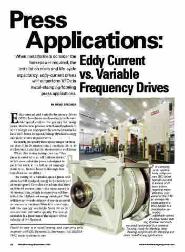

In stamping- press applica-
tions, eddy-cur- rent (EC) drives typically run well in excess of 20 years before requiring major attention, com-
pared to the 7-10 yr. average life expectancy of a VFD. Shown is a
combination air- cooled
adjustable-speed EC drive, brake, belt
ring flywheel and shaft- mounted tachometer in a common
housing, ready for blanking, deep
drawing, progressive-die stamping and other metalforming applications.
