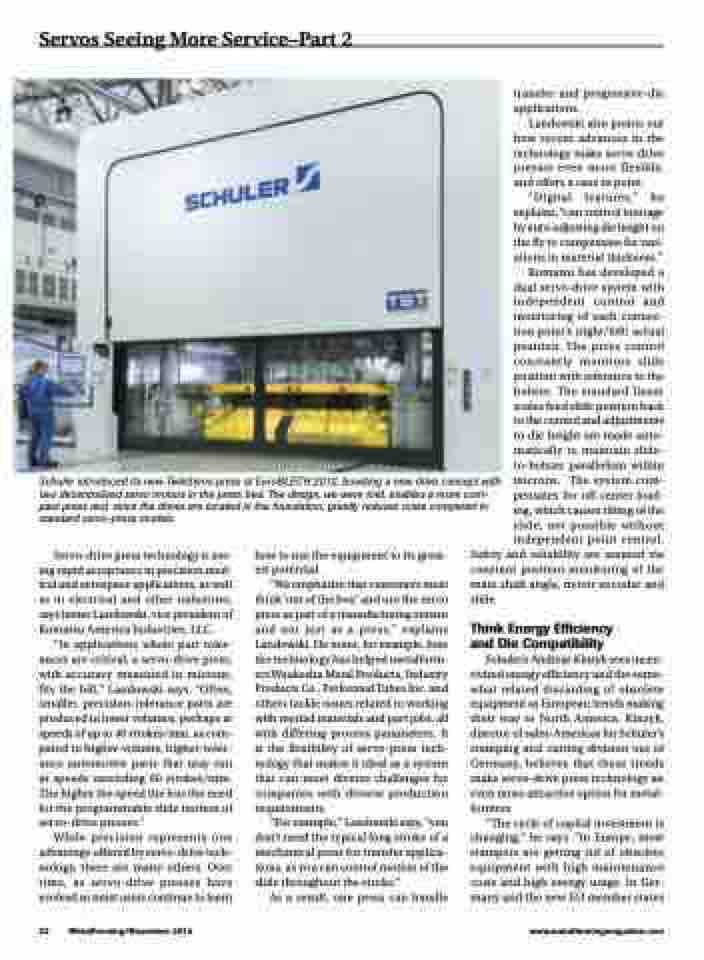

  Schuler introduced its new TwinServo press at EuroBLECH 2012, boasting a new drive concept with two decentralized servo motors in the press bed. The design, we were told, enables a more com- pact press and, since the drives are located in the foundation, greatly reduces noise compared to standard servo-press models.
