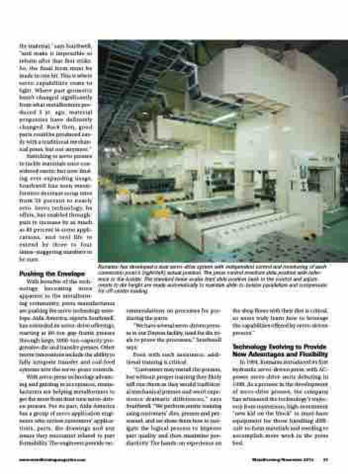

Komatsu has developed a dual servo-drive system with independent control and monitoring of each connection point’s (right/left) actual position. The press control monitors slide position with refer- ence to the bolster. The standard linear scales feed slide position back to the control and adjust- ments to die height are made automatically to maintain slide-to-bolster parallelism and compensate for off-center loading.
