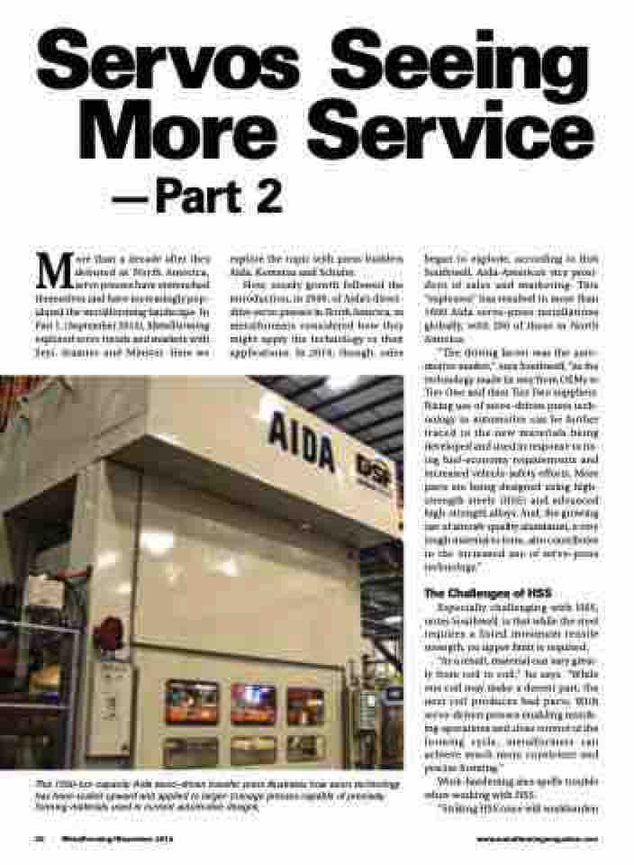

 This 1500-ton-capacity Aida servo-driven transfer press illustrates how servo technology has been scaled upward and applied to larger-tonnage presses capable of precisely forming materials used in current automotive designs.
