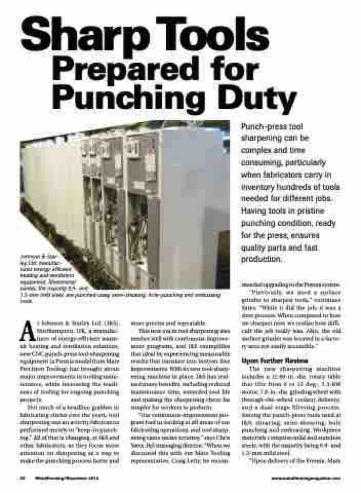

 Johnson & Star-
ley Ltd. manufac-
tures energy-efficient
heating and ventilation
equipment. Sheetmetal
panels, the majority 0.9- and
1.2-mm mild steel, are punched using semi-shearing, hole-punching and embossing tools.
