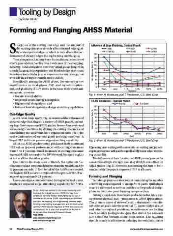

Sharpness of the cutting-tool edge and the amount of die-cutting clearance directly affect sheared edge qual- ity of stamped metal parts, which in turn affects the per- formance of sheared edges during forming and flanging.

Cut-Edge Quality
A U.S. Steel Corp. study (Fig. 1) examined the influence of sheared-edge finishing on a variety of AHSS grades, includ- ing high-hole expansion (HHE) grades. Researchers evaluated various edge conditions by altering die-cutting clearance and establishing the maximum hole-expansion ratio (HER) for each combination of material grade and edge condition. A larger HER indicates greater edge-stretching capability.
All of the AHSS grades tested produced their minimum HER values (poorest performance) with cutting clearances from 6 to 8 percent. Small increases in cutting clearance increased HER noticeably for DP 590 steel, but only slightly or not at all for the other grades.
Contrary to die-shop rules of thumb, the optimum die- clearance values were much higher than the traditional 8 to 12 percent per side. In fact, for all of the AHSS steels tested, the highest HER values correspond with a per-side die clear- ance of approximately 21 percent.
Laser-cut edges, commonly used during initial tool tryout, displayed superior edge-stretching capability for AHSS.

Fig. 1—From A. Konieczny and T. Henderson, U.S. Steel Corp.

Fig. 2—From A. Konieczny and T. Henderson, U.S. Steel Corp.
Replacing laser cutting with conventional cutting and punch- ing in production will lead to significantly lower edge-stretch- ing capability.
The influence of burr location on HER proves greater for conventional high-strength low-alloy (HSLA) steels than for AHSS grades (Fig. 2). However, positioning the burr to be in contact with the punch improves HER in all cases.
