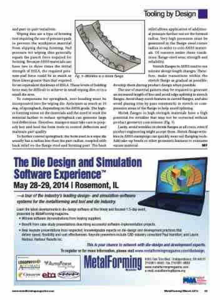

Shrink flanges in high-strength materials have a high potential for wrinkles that may not be corrected without
product geometry concessions (Fig. 3).
Lastly, avoid wrinkles in shrink flanges at all costs, even if
product engineering might accept them. Shrink-flange wrin- kles in AHSS stampings can quickly wear out flanging tools. Add take-up beads or other geometric features to consume excess material. MF
Fig. 3—Wrinkles in a shrink flange.
