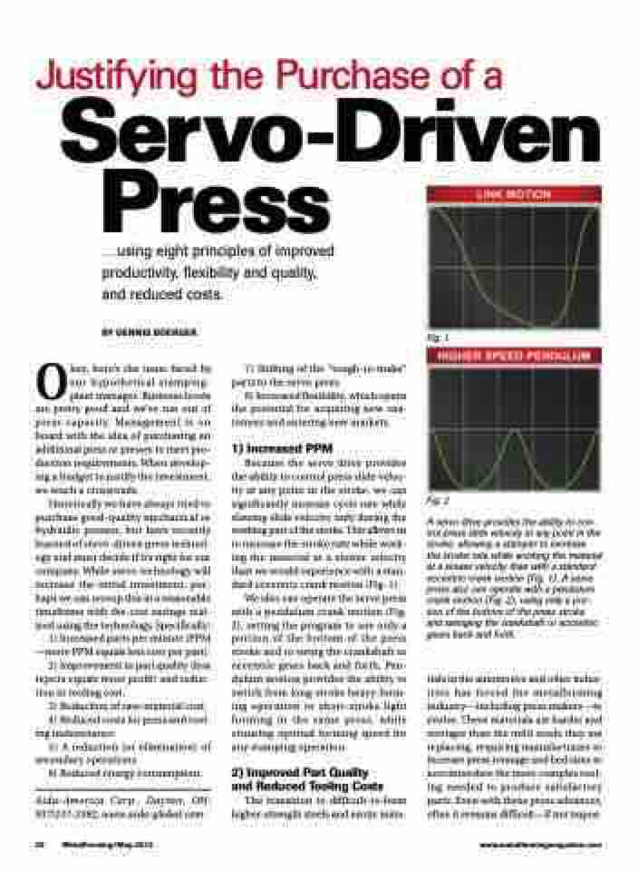

1) Increased PPM
Because the servo drive provides the ability to control press slide veloc- ity at any point in the stroke, we can significantly increase cycle rate while slowing slide velocity only during the working part of the stroke. This allows us to increase the stroke rate while work- ing the material at a slower velocity than we would experience with a stan- dard eccentric crank motion (Fig. 1).
We also can operate the servo press with a pendulum crank motion (Fig. 2), setting the program to use only a portion of the bottom of the press stroke and to swing the crankshaft or eccentric gears back and forth. Pen- dulum motion provides the ability to switch from long-stroke heavy-form- ing operation to short-stroke light forming in the same press, while ensuring optimal forming speed for any stamping operation.

Fig. 1
Fig. 2
A servo drive provides the ability to con- trol press slide velocity at any point in the stroke, allowing a stamper to increase
the stroke rate while working the material at a slower velocity than with a standard eccentric crank motion (Fig. 1). A servo press also can operate with a pendulum crank motion (Fig. 2), using only a por- tion of the bottom of the press stroke and swinging the crankshaft or eccentric gears back and forth.
