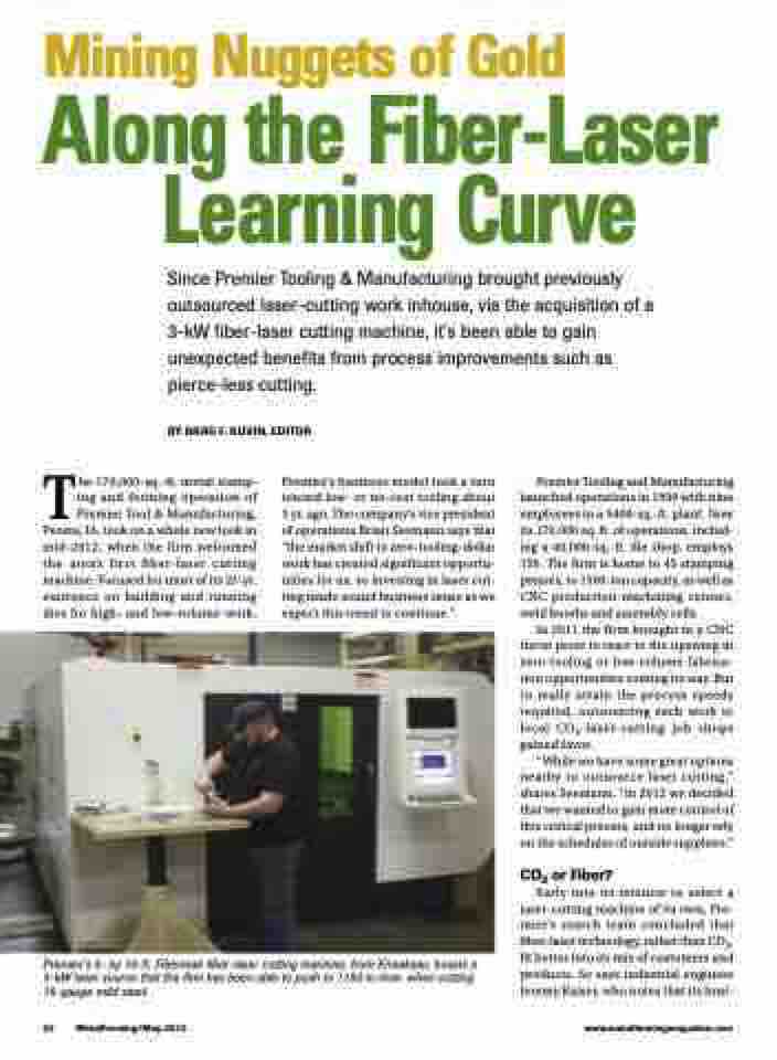

 Premier’s 5- by 10-ft. Fibermak fiber-laser cutting machine, from Ermaksan, boasts a 3-kW laser source that the firm has been able to push to 1180 in./min. when cutting 16-gauge mild steel.
