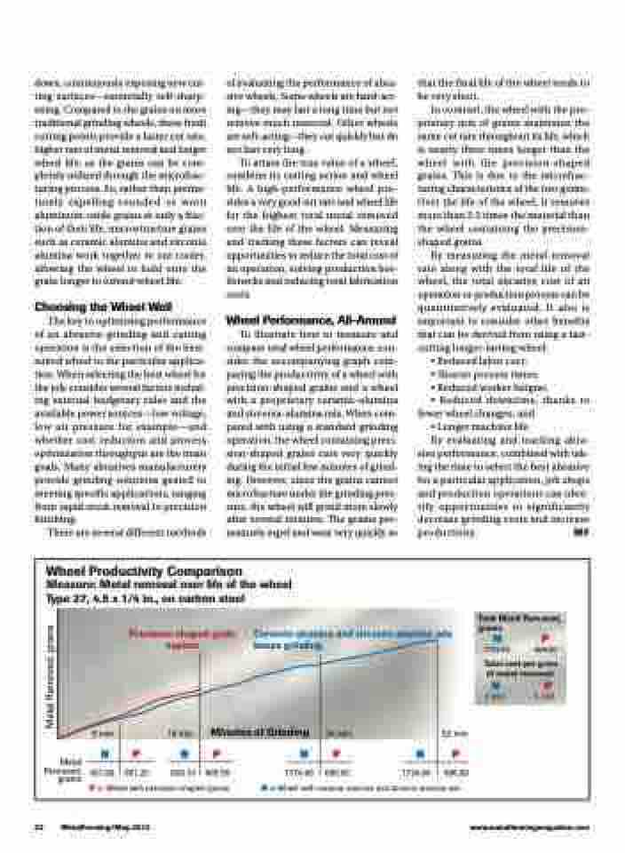

To illustrate how to measure and compare total wheel performance, con- sider the accompanying graph com- paring the productivity of a wheel with precision-shaped grains and a wheel with a proprietary ceramic-alumina and zirconia-alumina mix. When com- pared with using a standard grinding operation, the wheel containing preci- sion-shaped grains cuts very quickly during the initial few minutes of grind- ing. However, since the grains cannot microfracture under the grinding pres- sure, the wheel will grind more slowly after several minutes. The grains pre- maturely expel and wear very quickly so
that the final life of the wheel tends to be very short.
In contrast, the wheel with the pro- prietary mix of grains maintains the same cut rate throughout its life, which is nearly three times longer than the wheel with the precision-shaped grains. This is due to the microfrac- turing characteristics of the two grains. Over the life of the wheel, it removes more than 2.5 times the material than the wheel containing the precision- shaped grains.
By measuring the metal-removal rate along with the total life of the wheel, the total abrasive cost of an operation or production process can be quantitatively evaluated. It also is important to consider other benefits that can be derived from using a fast- cutting longer-lasting wheel:

  Wheel Productivity Comparison Measure: Metal removal over life of the wheel Type 27, 4.5 x 1/4 in., on carbon steel
   Precision-shaped grain expires
Ceramic-alumina and zirconia-alumina mix keeps grinding
Total Metal Removed, grams
NP 1724.90 696.50
Total cost per gram of metal removed
NP
     Metal grams
$ .001
$ .003
 8 min.
16 min.
Minutes of Grinding
34 min.
52 min.
NPNP NP NP Removed, 301.90 361.20 600.10 695.50 1174.80 696.50 1724.90 696.50
    P = Wheel with precision-shaped-grains N = Wheel with ceramic alumina and zirconia alumina mix
