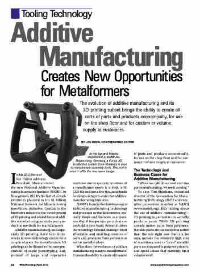

In the jigs and fixtures department at BMW AG,
Regensberg, Germany, a Fortus 3D production system from Stratasys is used to manufacture assembly tools. This tool is
used to affix the rear name badge.
