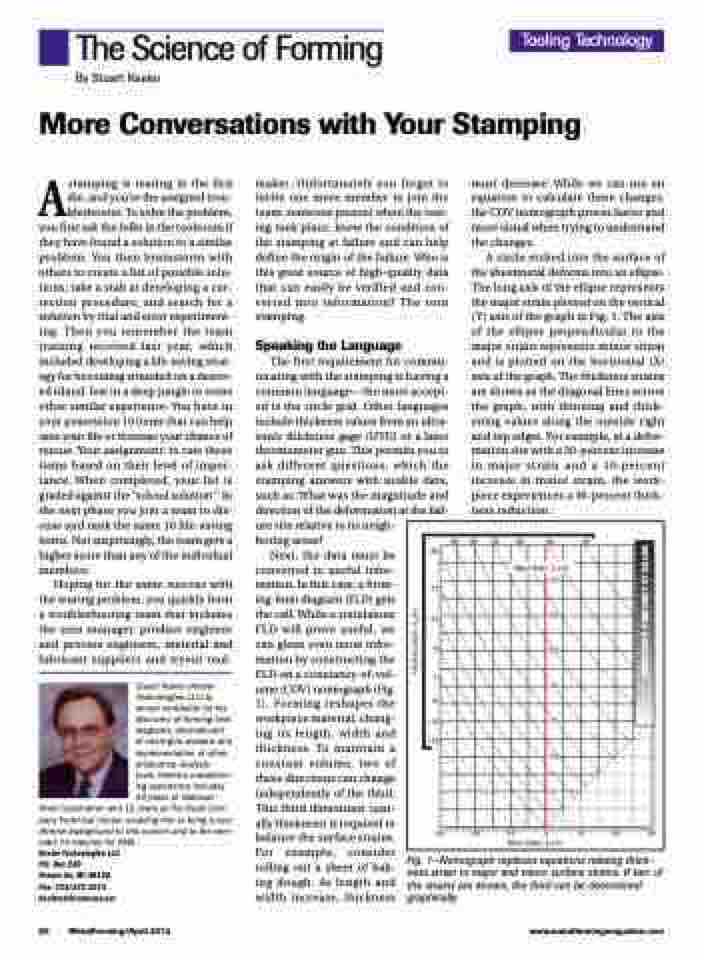

The first requirement for commu- nicating with the stamping is having a common language—the most accept- ed is the circle grid. Other languages include thickness values from an ultra- sonic thickness gage (UTG) or a laser thermometer gun. This permits you to ask different questions, which the stamping answers with usable data, such as: What was the magnitude and
must decrease. While we can use an equation to calculate these changes, the COV nomograph proves faster and more visual when trying to understand the changes.
A circle etched into the surface of the sheetmetal deforms into an ellipse. The long axis of the ellipse represents the major strain plotted on the vertical (Y) axis of the graph in Fig. 1. The axis of the ellipse perpendicular to the major strain represents minor strain and is plotted on the horizontal (X) axis of the graph. The thickness strains are shown as the diagonal lines across the graph, with thinning and thick- ening values along the outside right and top edges. For example, at a defor- mation site with a 30-percent increase in major strain and a 10-percent increase in minor strain, the work- piece experiences a 30-percent thick- ness reduction.

Next, the data must be converted to useful infor- mation. In this case, a form- ing-limit diagram (FLD) gets the call. While a standalone FLD will prove useful, we can glean even more infor- mation by constructing the FLD on a constancy-of-vol- ume (COV) nomograph (Fig. 1). Forming reshapes the workpiece material, chang- ing its length, width and thickness. To maintain a constant volume, two of these directions can change independently of the third. This third dimension (usu- ally thickness) is required to balance the surface strains. For example, consider rolling out a sheet of bak- ing dough. As length and width increase, thickness
at the fail-
  Fig. 1—Nomograph replaces equations relating thick- ness strain to major and minor surface strains. If two of the strains are known, the third can be determined graphically.
