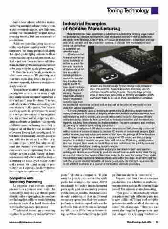

 Shown are polycarbonate hydroforming tools produced from the patented Fused Deposition Modeling (FDM) additive-manufacturing process. The tools have proven lives of more than 600 cycles in forming aerospace-grade aluminum parts to 0.100 in. thick, according to Stratasys.
