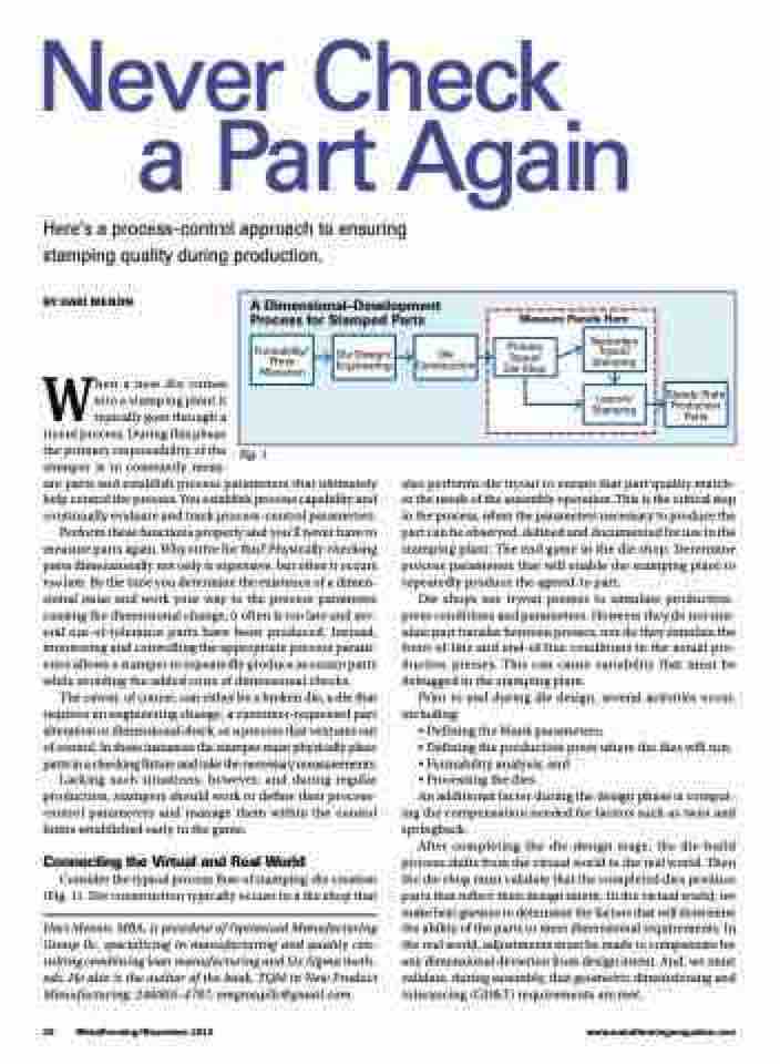

  A Dimensional-Development Process for Stamped Parts
   Measure Panels Here
     Formability/ Press Allocation
Die Design/ Engineering
Die Construction
Primary Tryout/ Die Shop
Secondary Tryout/ Stamping
         Launch/ Stamping
Steady State Production Parts

Consider the typical process flow of stamping-die creation (Fig. 1). Die construction typically occurs in a die shop that
Hari Menon, MBA, is president of Optimized Manufacturing Group llc, specializing in manufacturing and quality con- sulting combining lean manufacturing and Six Sigma meth- ods. He also is the author of the book, TQM in New Product Manufacturing: 248/805-4787; omgroupllc@gmail.com.
Fig. 1
also performs die tryout to ensure that part quality match- es the needs of the assembly operation. This is the critical step in the process, when the parameters necessary to produce the part can be observed, defined and documented for use in the stamping plant. The end game in the die shop: Determine process parameters that will enable the stamping plant to repeatedly produce the agreed-to part.
Die shops use tryout presses to simulate production- press conditions and parameters. However they do not sim- ulate part transfer between presses, nor do they simulate the front-of-line and end-of-line conditions in the actual pro- duction presses. This can cause variability that must be debugged in the stamping plant.
