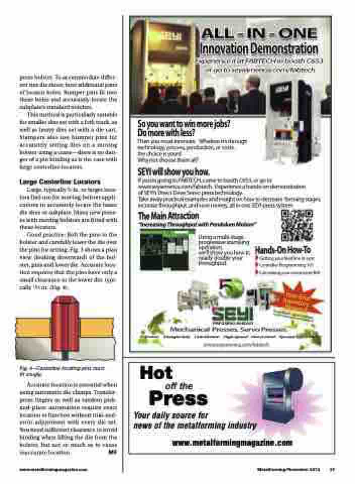

Large, typically 3-in. or larger loca- tors find use for moving-bolster appli- cations to accurately locate the lower die shoe or subplate. Many new press- es with moving bolsters are fitted with these locators.
Good practice: Bolt the pins to the bolster and carefully lower the die over the pins for setting. Fig. 3 shows a plan view (looking downward) of the bol- ster, pins and lower die. Accurate loca- tion requires that the pins have only a small clearance in the lower die, typi- cally 1⁄16 in. (Fig. 4).

Fig. 4—Centerline locating pins must fit snugly.
Accurate location is essential when using automatic die clamps. Transfer- press fingers as well as tandem pick- and-place automation require exact location to function without trial-and- error adjustment with every die set. You need sufficient clearance to avoid binding when lifting the die from the bolster, but not so much as to cause inaccurate location. MF
