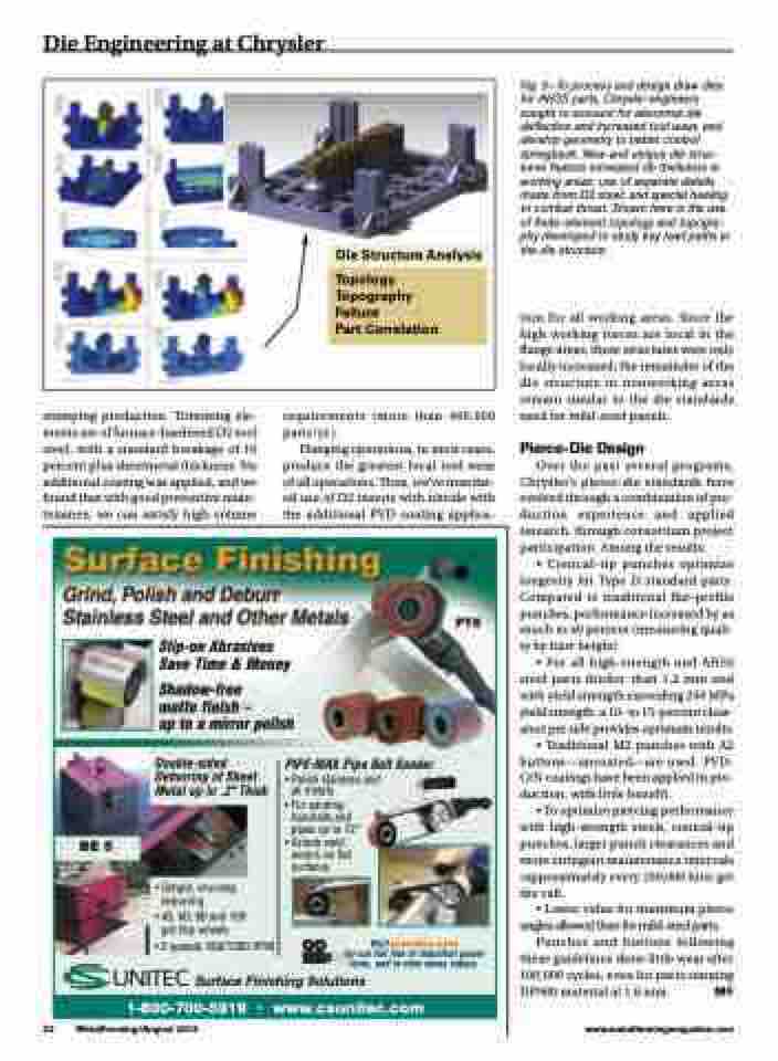

                  Die Engineering at Chrysler
      Die Structure Analysis
 Topology Topography Failure
Part Correlation
stamping production. Trimming ele- ments are of furnace-hardened D2 tool steel, with a standard breakage of 10 percent plus sheetmetal thickness. No additional coating was applied, and we found that with good preventive main- tenance, we can satisfy high-volume
requirements (more than 400,000 parts/yr.).
Flanging operations, in most cases, produce the greatest local tool wear of all operations. Thus, we’ve mandat- ed use of D2 inserts with nitride with the additional PVD coating applica-
Fig. 5—To process and design draw dies for AHSS parts, Chrysler engineers sought to account for abnormal die deflection and increased tool wear, and develop geometry to better control springback. New and unique die struc- tures feature increased rib thickness in working areas; use of separate details made from D2 steel; and special heeling to combat thrust. Shown here is the use of finite-element topology and topogra- phy developed to study key load paths in the die structure.
tion for all working areas. Since the high working forces are local in the flange areas, these structures were only locally increased; the remainder of the die structure in nonworking areas remain similar to the die standards used for mild-steel panels.
