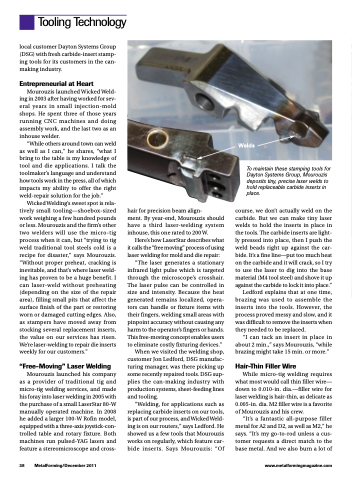

To maintain these stamping tools for Dayton Systems Group, Mourouzis deposits tiny, precise laser welds to hold replaceable carbide inserts in place.
course, we don’t actually weld on the carbide. But we can make tiny laser welds to hold the inserts in place in the tools. The carbide inserts are light- ly pressed into place, then I push the weld beads right up against the car- bide. It’s a fine line—put too much heat on the carbide and it will crack, so I try to use the laser to dig into the base material (M4 tool steel) and shove it up against the carbide to lock it into place.”
