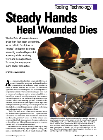

Wicked Welding’s Pete Mourouzis has two laser-welding machines at his disposal, to make tooling repairs—an 80-W manual machine (top) for hand-held work, and a 100-W machine with a three-axis rotary fixture table for more precise work. Both require him to perform three actions at once—foot-pedal control of the pulsed laser, right- hand manipulation of the part, and left-hand filler-wire feed into the weld. Shielding gas (pure argon) flows through the blue hose to pro- tect the tiny welds from the atmosphere.
