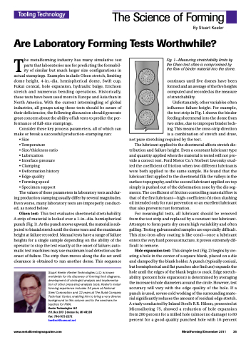

Olsen test: This test evaluates sheetmetal stretchability. A strip of material is locked over a 1-in.-dia. hemispherical punch (Fig. 1). As the punch moves upward, the material is sub- jected to biaxial stretch until the dome tears and the maximum height at failure recorded. Manual tests have a range of failure heights for a single sample depending on the ability of the operator to stop the test exactly at the onset of failure; auto- matic test machines may use maximum load detection as the onset of failure. The strip then moves along the die set until clearance is obtained to run another dome. This sequence

Fig. 1—Measuring stretchability limits by the Olsen test often is compromised by the flow of binder material into the dome.
continues until five domes have been formed and an average of the five heights computed and recorded as the measure of stretchability.
Unfortunately, other variables often influence failure height. For example, the test strip in Fig. 1 shows the binder feeding sheetmetal into the dome from two sides, due to improper binder lock- ing. This means the cross-strip direction is a combination of stretch and draw,
not pure stretching required by the test.
