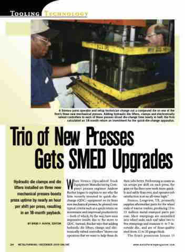

 A Stemco press operator and setup technician change out a compound die on one of the firm’s three new mechanical presses. Adding hydraulic die lifters, clamps and electronically valved controllers to each of these presses sliced die-change time nearly in half; the firm calculated an 18-month return on investment for the quick-die-change apparatus.
