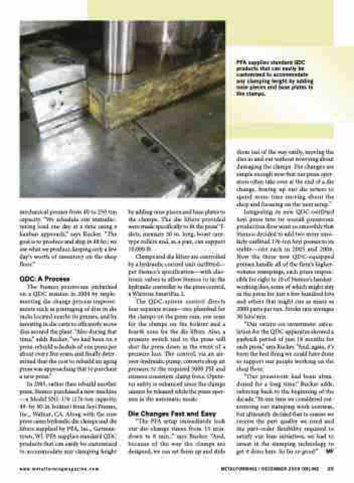

In 2005, rather than rebuild another press, Stemco purchased a new machine —a Model SN1-176 (176 ton capacity, 49- by 30-in. bolster) from Seyi Presses, Inc., Walnut, CA. Along with the new press came hydraulic die clamps and die lifters supplied by PFA, Inc., German- town, WI. PFA supplies standard QDC products that can easily be customized to accommodate any clamping height
by adding nose pieces and base plates to the clamps. The die lifters provided were made specifically to fit the press’ T- slots, measure 30 in. long, boast cam- type rollers and, as a pair, can support 10,000 lb.
Clamps and die lifters are controlled by a hydraulic control unit outfitted— per Stemco’s specification—with elec- tronic valves to allow Stemco to tie the hydraulic controller to the press control, a Wintriss SmartPac 2.
The QDC-system control directs four separate zones—two plumbed for the clamps on the press ram, one zone for the clamps on the bolster and a fourth zone for the die lifters. Also, a pressure switch tied to the press will shut the press down in the event of a pressure loss. The control, via an air- over-hydraulic pump, converts shop air pressure to the required 5000 PSI and ensures consistent clamp force. Opera- tor safety is enhanced since the clamps cannot be released while the press oper- ates in the automatic mode.
Die Changes Fast and Easy
“The PFA setup immediately took our die-change times from 15 min. down to 8 min.,” says Rucker. “And, because of the way the clamps are designed, we can set them up and slide
them out of the way easily, moving the dies in and out without worrying about damaging the clamps. Die changes are simple enough now that our press oper- ators often take over at the end of a die change, freeing up our die setters to spend more time moving about the shop and focusing on the next setup.”

 PFA supplies standard QDC products that can easily be customized to accommodate any clamping height by adding nose pieces and base plates to the clamps.
