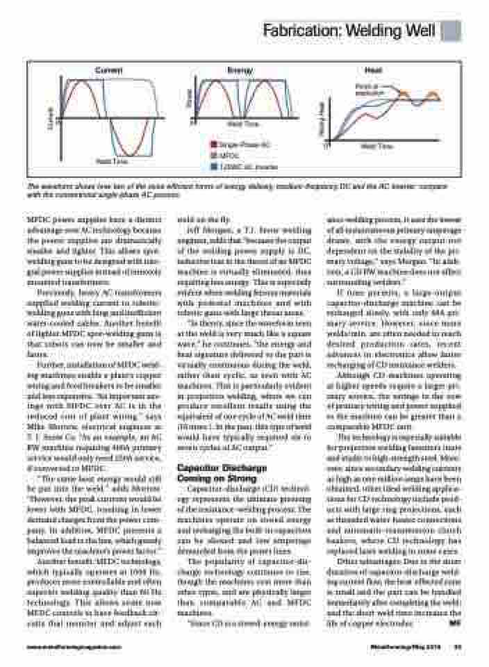

  The waveform shows how two of the more efficient forms of energy delivery, medium-frequency DC and the AC inverter, compare with the conventional single-phase AC process.

Another benefit: MFDC technology, which typically operates at 1000 Hz, produces more controllable and often superior welding quality than 60 Hz technology. This allows some new MFDC controls to have feedback cir- cuits that monitor and adjust each

“In theory, since the waveform seen at the weld is very much like a square wave,” he continues, “the energy and heat signature delivered to the part is virtually continuous during the weld, rather than cyclic, as seen with AC machines. This is particularly evident in projection welding, where we can produce excellent results using the equivalent of one cycle of AC weld time (16 msec.). In the past, this type of weld would have typically required six to seven cycles of AC output.”
