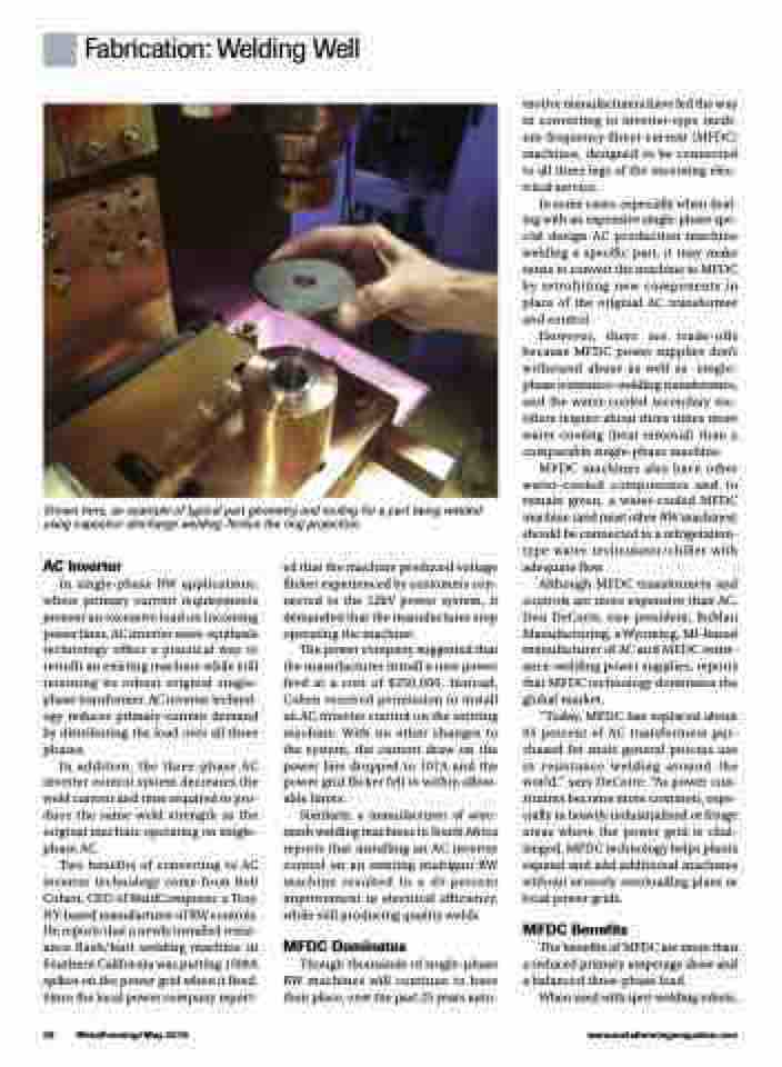

 Shown here, an example of typical part geometry and tooling for a part being welded using capacitor-discharge welding. Notice the ring projection.
