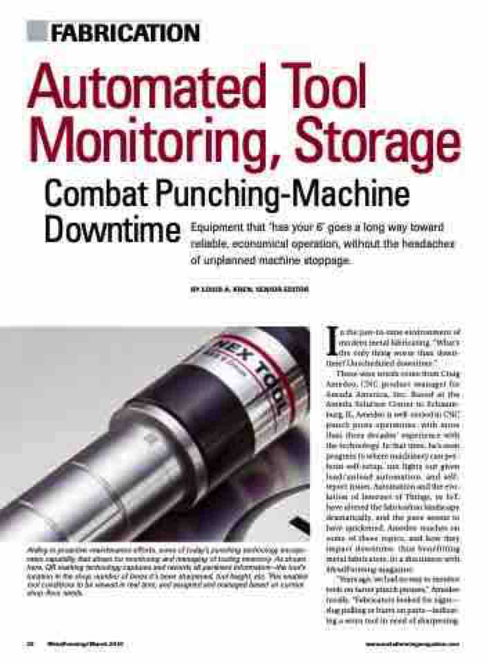

 Aiding in proactive-maintenance efforts, some of today’s punching technology incorpo- rates capability that allows for monitoring and managing of tooling inventory. As shown here, QR marking technology captures and records all pertinent information—the tool’s location in the shop, number of times it’s been sharpened, tool height, etc. This enables tool conditions to be viewed in real time, and assigned and managed based on current shop-floor needs.
