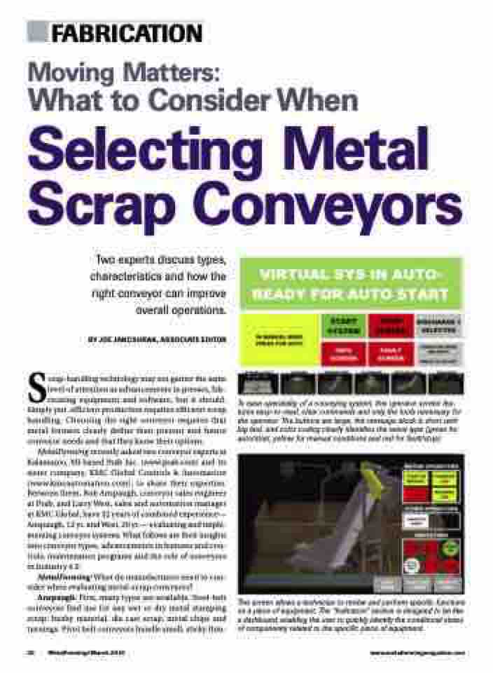

To ease operability of a conveying system, this operator screen fea- tures easy-to-read, clear commands and only the tools necessary for the operator. The buttons are large, the message block is short with big text, and color coding clearly identifies the event type (green for auto/start, yellow for manual conditions and red for fault/stop).
This screen allows a technician to review and perform specific functions on a piece of equipment. The “Indicators” section is designed to be like a dashboard, enabling the user to quickly identify the conditional states of componentry related to the specific piece of equipment.
