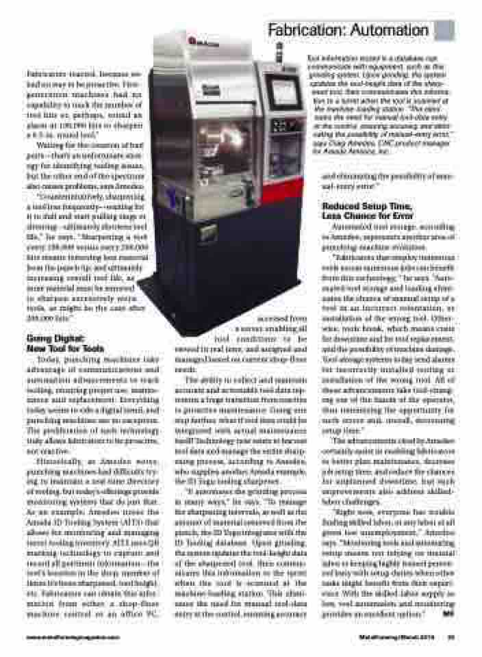

Tool information stored in a database can communicate with equipment, such as this
grinding system. Upon grinding, the system updates the tool-height data of the sharp-
ened tool, then communicates this informa- tion to a turret when the tool is scanned at
the machine-loading station. “This elimi- nates the need for manual tool-data entry at the control, ensuring accuracy and elimi-
nating the possibility of manual-entry error,” says Craig Amedeo, CNC product manager for Amada America, Inc.
