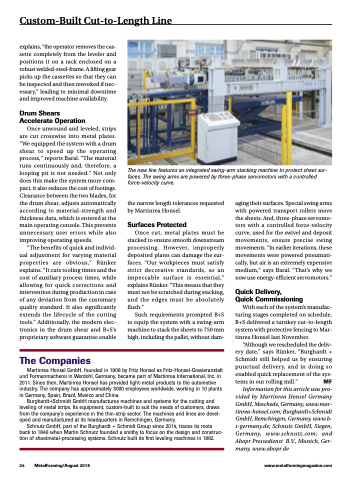

The new line features an integrated swing-arm stacking machine to protect sheet sur- faces. The swing arms are powered by three-phase servomotors with a controlled force-velocity curve.

Once cut, metal plates must be stacked to ensure smooth downstream processing. However, improperly deposited plates can damage the sur- faces. “Our workpieces must satisfy strict decorative standards, so an impeccable surface is essential,” explains Rünker. “This means that they must not be scratched during stacking, and the edges must be absolutely flush.”
Such requirements prompted B+S to equip the system with a swing-arm machine to stack the sheets to 750 mm high, including the pallet, without dam-
aging their surfaces. Special swing arms with powered transport rollers move the sheets. And, three-phase servomo- tors with a controlled force-velocity curve, used for the swivel and deposit movements, ensure precise swing movements. “In earlier iterations, these movements were powered pneumati- cally, but air is an extremely expensive medium,” says Baral. “That’s why we now use energy-efficient servomotors.”
