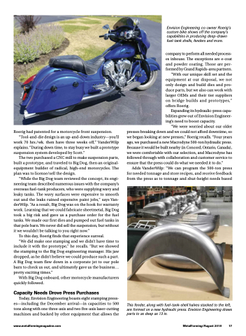

Envision Engineering co-owner Roerig’s custom bike shows off the company’s capabilities in producing deep-drawn fuel-tank shells, fenders and more.

This fender, along with fuel-tank-shell halves stacked to the left, are formed on a new hydraulic press. Envision Engineering draws parts to as deep as 13 in.
