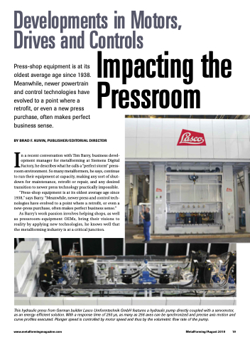

  This hydraulic press from German builder Lasco Umformtechnik GmbH features a hydraulic pump directly coupled with a servomotor, as an energy-efficient solution. With a response time of 250 μs, as many as 256 axes can be synchronized and precise axis motion and curve profiles executed. Plunger speed is controlled by motor speed and thus by the volumetric flow rate of the pump.
