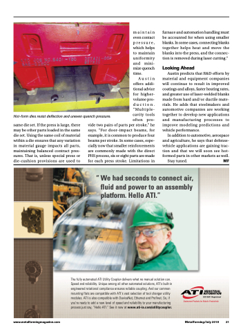

                  Hot-form dies resist deflection and uneven quench pressure.
maintain even contact pressure, which helps to maintain uniformity and mini- mize quench time.

same die set. If the press is large, there may be other parts loaded in the same die set. Using the same coil of material within a die ensures that any variation in material gauge impacts all parts, maintaining balanced contract pres- sures. That is, unless special press or die-cushion provisions are used to
often pro- vide two pairs of parts per stroke,” he says. “For door-impact beams, for example, it is common to produce four beams per stroke. In some cases, espe- cially now that smaller reinforcements are commonly made with the direct PHS process, six or eight parts are made for each press stroke. Limitations in
