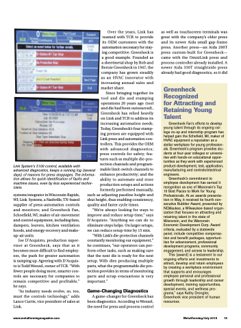

 Link System’s 5100 control, available with advanced diagnostics, keeps a running log (several days) of reasons for press stoppages. The informa- tion allows for quick identification of faults and machine issues, even by less experienced techni- cians.
