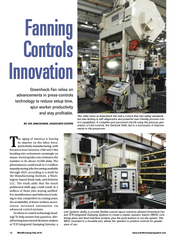

Greenheck Fan relies on advancements in press-controls technology to reduce setup time, spur worker productivity and stay profitable.
This older press at Greenheck Fan had a control that met safety standards but was lacking in self-diagnostics and powerful user-friendly process-con- trol capabilities. A complete and successful retrofit using the previous gen- eration of Link controls, the OmnLink 5000, led to a succession of improve- ments in the pressroom.

Link Systems’ ability to provide flexible custom layout solutions allowed Greenheck Fan and TCR Integrated Stamping Systems to create a master operator station (MOS) com- bining press and feed-interface screens, plus the push buttons to run the system. This MOS, mounted to a movable arm, allows the operator to position controls for greater ease of use.
