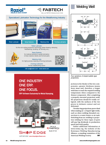

Four variations of simple bubble-type projections.
jections in the thicker of the two com- ponents—greater thickness means more mass and, therefore, a longer weld time to reach the required welding temperature when compared to the thinner component. After completing a properly executed projection weld, the projections should be totally col- lapsed, with the surfaces of the two pieces in intimate contact and not deformed.
Circular ring projections prove ideal when making air- or liquid-tight welds, such as when welding threaded con- nections to a water heater or air tank. Switching from arc welding to projec- tion welding for these types of parts will pay big dividends in production speed and weld quality.
Gather additional information at www.rwma.org, the website of the Resistance Welding Manufacturing Alliance, a standing committee of the American Welding Society. MF
