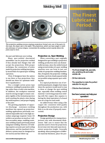

                            This projection-welding process employs projections formed onto one of the parts (in this case, the drawn cup to the right). The projections, which can have single or multi- ple embosses of various shapes, concentrate the welding current exactly where the joints need to form.
