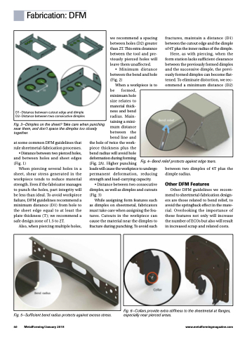

 D1–Distance between cutout edge and dimple D2–Distance between two consecutive dimples
 Fig. 3—Dimples on the sheet? Take care when punching near them, and don’t space the dimples too closely together.

• Distance between two consecutive dimples, as well as dimples and cutouts (Fig. 3)
While assigning form features such as dimples on sheetmetal, fabricators must take care when assigning the fea- tures. Cutouts in the workpiece can cause the material near the dimples to fracture during punching. To avoid such
we recommend a spacing between holes (D2) greater than 2T. This extra clearance between the tool and pre- viously pierced holes will leave them unaffected.

fractures, maintain a distance (D1) between the cutout edge and the dimple of 4T plus the inner radius of the dimple.
Here, as with piercing, when the form station lacks sufficient clearance between the previously formed dimples and the successive dimple, the previ- ously formed dimples can become flat- tened. To eliminate distortion, we rec- ommend a minimum distance (D2)
Fig. 4—Bend relief protects against edge tears.
  Fig. 6—Collars provide extra stiffness to the sheetmetal at flanges, Fig. 5—Sufficient bend radius protects against excess stress. especially near pierced areas.
40 MetalForming/January 2018
between two dimples of 4T plus the dimple radius.

Other DFM guidelines we recom- mend to sheetmetal-fabrication design- ers are those related to bend relief, to avoid the springback effect in the mate- rial. Overlooking the importance of these features not only will increase the number of ECOs but also will result in increased scrap and related costs.
