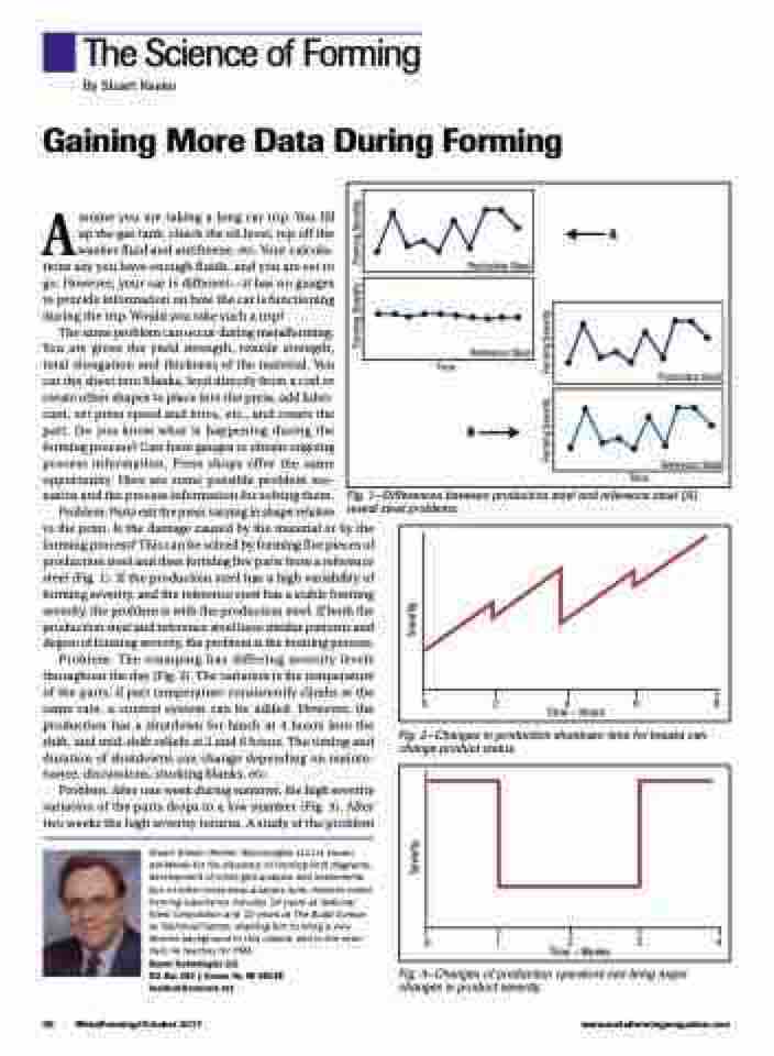

narios and the process information for solving them. Fig. 1—Differences between production steel and reference steel (A)
Problem: Parts exit the press varying in shape relative reveal steel problems. to the print. Is the damage caused by the material or by the
forming process? This can be solved by forming five pieces of
production steel and then forming five parts from a reference
                          Time
B
Production Steel
Reference Steel
A
             Production Steel
             Time
Reference Steel
       02468
Time – Hours
steel (Fig. 1). If the production steel has a high variability of forming severity, and the reference steel has a stable forming severity, the problem is with the production steel. If both the production steel and reference steel have similar patterns and degree of forming severity, the problem is the forming process.
Problem: The stamping has differing severity levels throughout the day (Fig. 2). The variation is the temperature of the parts; if part temperature consistently climbs at the same rate, a control system can be added. However, the production has a shutdown for lunch at 4 hours into the shift, and mid-shift reliefs at 2 and 6 hours. The timing and duration of shutdowns can change depending on mainte- nance, discussions, stocking blanks, etc.
Problem: After one week during summer, the high severity variation of the parts drops to a low number (Fig. 3). After two weeks the high severity returns. A study of the problem

Fig. 2—Changes in production shutdown time for breaks can change product status.

Fig. 3—Changes of production operators can bring major changes in product severity.
