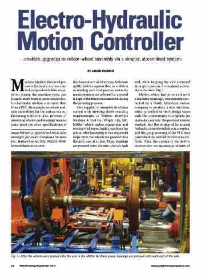

One supplier of assembly machines tasked with meeting these exacting requirements is Mittler Brothers Machine & Tool Co., Wright City, MO. Mittler, which makes equipment and tooling of all types, builds machines for railcar-wheel assembly in two sequential steps. First, the wheels are pressed onto the axle, one at a time. Then, bearings are pressed onto the axle, one on each
end, while keeping the axle centered during the process. A completed assem- bly is shown in Fig. 1.
Mittler, which had produced such a machine years ago, was recently con- tacted by a North American railcar company to produce a new machine, which provided Mittler’s design team with the opportunity to upgrade its hydraulic controls. The previous system worked, but the wiring of its analog hydraulic control module was complex, and the programming of the PLC that controlled the overall motion was dif- ficult. Plus, the company wanted to incorporate an automatic means of
  Fig. 1—After the wheels are pressed onto the axle in the Mittler Brothers press, bearings are pressed onto each end of the axle.
